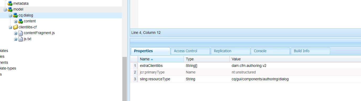

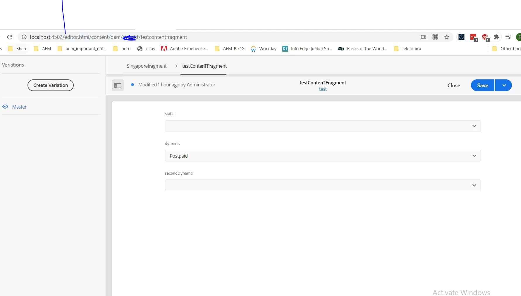

i want to load custom clientlibs in my content fragment page but the js call is not getting called.
http://localhost:4502/editor.html/content/dam/test/testcontentfragment
i am using categories - dam.cfm.authoring.v2
But still my js is not geting called.

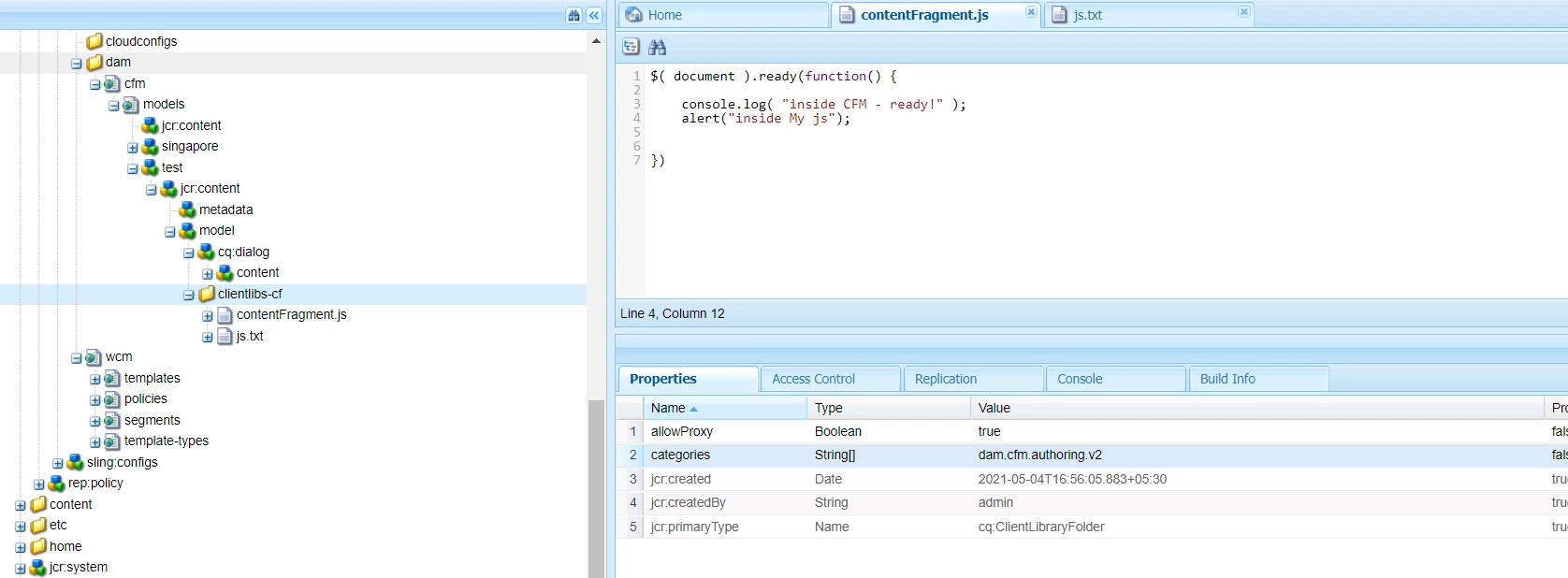

Best answer by Vijayalakshmi_S
Hi @raushan,
Please try dam.cfm.authoring.contenteditor.v2. This has the editor.js file which gets called on CF Editor.
Respective clientlibs path is available here - /libs/dam/cfm/admin/clientlibs/v2/authoring/contenteditor

Hi @shashi_mulugu i have tried dam.cfm.authoring.editors.v2 , but this is also not working. when I am checking js file inside libs , it's showing category name dam.cfm.authoring.v2   but with this it's also not working. is my clientlibs folder location is correct.? please find the libs clientlib attachment.

Vijayalakshmi_SAccepted solution
May 13, 2021
Hi @raushan,
