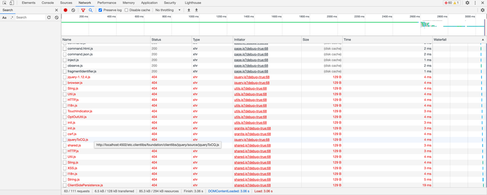

1. Clientlibs are not loading in AEM storefront.Screenshot 2021-05-12 at 12.40.26 AM.png

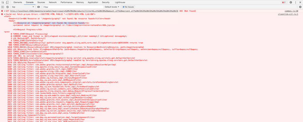

2. Getting error in console :Resource at '/magento/graphql' not found: No resource found.

I am running AEM 6.5 and Magento on same machine(for development) so I don't need proxy server. The issue was with magneto running on https and certificate was creating issue. CSS issue is a different issue. Looks like Archtype 27 with AEM 6.5.7 and Commerce enabled does not come with the css or scss files are not properly generating as npm build is not happening properly. I tried copying css from Venia project and it worked.
