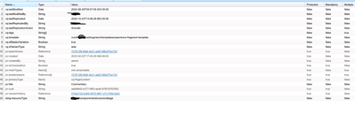

Can you cross check once if your exp fragment variations have cq:xfVariantType property available or not. And share some screenshots if possible. I am on AEM 6.5.21 and the API responsible for checking the validity seems to be bin/wcm/experiencefragments/verifyreferences.json which is validating if the selected value is an actual exp fragment variation or not.
Below is the screenshot from the environment where we are seeing this issue. Yes, cq:xfVariantType property is available.
