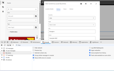

Issue Regarding inner html while using dialog dropdown
Uncaught TypeError: Cannot read properties of null (reading 'innerText')
at HTMLElement._onOverlayToggle (coralui3.js:940:484)
at Vent._executeListenersAtElement (coralui3.js:249:294)
at Vent._executeBubbleListeners (coralui3.js:252:219)
at Coral.Component.trigger (coralui3.js:354:7)
at openComplete (coralui3.js:399:29)
at coralui3.js:399:143
I am getting this issue when accessing dropdown in authoring field ,any one suggest the solution for this

Hi Santhosh,
Thanks for your suggestions!
we are using the same coral form select and we have checked with this
document.querySelectorAll('coral-select').forEach(select => {
  console.log(select, select.innerText);
no issues found either null or errors.
Everything seems fine.
But when we trying to open the state dropdown which is rendering data by using datasource,we facing the same issue as inner Text.
explicitly we not using innerText anywhere.
no issues before clicking the state dropdown.
After clicking the state dropdown,we are getting this issue,even checked with removing dialog js file completely,it showing the same.
issue is not because of js file.
one more to add after every deployment,state dropdown is not loading for some sometime.
Anyone please suggest!
