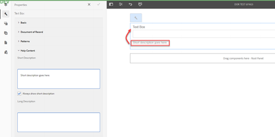

In AEM forms is there any way to make the 'Short description' appear under the field label instead of beneath the field?
In AEM forms, we'd like the 'Short description' field to be displayed below the field's label, instead of below the input box itself.  Is there a way to do this with the out-of-the-box fields in AEM?  I looked around for a setting in the form and theme but didn't see anything.

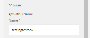

7) Then go to your form and give the name for the text box as "testingtestbox".
after the above changes, you can see output as below.
The second text box name is testingtestbox , that is why the short description display under the Textbox.
I have attached the package here, you can install into your local instance and then you need to make only once change. Go to your form and change the name of the text box as testingtestbox <Because we are checking this name in the jsp code>
