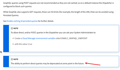

Documentation reads ability to run direct direct queries may get deprecated.
Until we too migrate content fragments into better solutions, looking for running direct queries. Is there documentation how to implement?

Please open the graphql editor console and type the query with all the elements and open the network tab and then run the query then you should be able to see a api call in the network tab which internall calls graphql endpoint with the requested elements.
This way you need not to use persistent query and you can directly call the graphql endpoint without using persistent query. This is what hitting the graphql with direct queries.
agreed. hacky way indeed works. Was looking for list of osgi config, dispatcher, env variables etc to run query at publisher upto production.
Documentation provides how to get started
And I was able to resolve schema
But still working to figure dispatcher and publisher osgi config.
