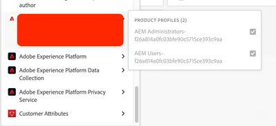

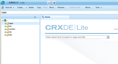

Created a program in adobe cloud and created 3 environments those are dev, stage, prod. I am the system administrator in admin console so I have full access in admin console. I want to have admin access in dev hence I enabled both AEM Users-xxxxx & AEM Administrator -xxxxx product profiles. With these settings I am able to login in aem dev server but I dont have access to /conf and /var, seems like I dont have have admin access.
I checked the user admin in aem, I could not see AEM Administrator -xxxxx group mapped to my name. Can you tell me how to enable admin access ? Do we have any local admin for dev env?

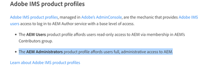

@Mario248  you should add your self as a administator in user groups in admin console. Refer to below link based on your requirement, below link helps you a lot.
https://experienceleague.adobe.com/docs/experience-manager-learn/cloud-service/accessing/overview.ht...
Level 9
Thanks for your response. As per this doc, I added AEM Administrator group to my name but I dont have admin access
