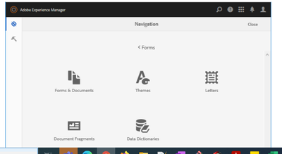

@Snow123,
As per my knowledge, you can go validate forms installation like below.
Forms enabled
Forms not enabled
alternatively, you can check the Adaptive Forms Configuration Service is exist in your AEM.
Hope this helps you!!
