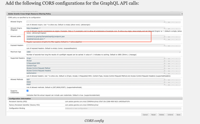

}I verified both Graphql and CF present on AEM publish instance. Also I enabled below two config as per https://statics.teams.cdn.office.net/evergreen-assets/safelinks/1/atp-safelinks.html
There is no error message on log file. Is there anything else I should check ?
