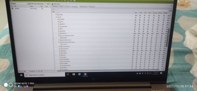

3. can you please share the screenshot with user permissions if possible by striking out client information?

3.Please find attached screenshots.
