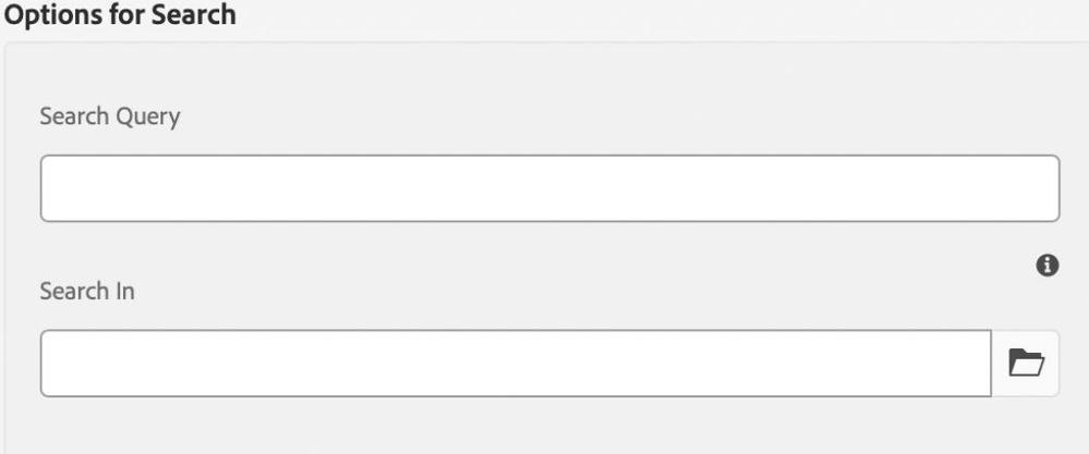

Hello Community Members,
could you please suggest the query I should use in the following list component to retrieve pages located on /content/abc/ path filtered by their last modified date and only showing the pages modified within last 2 days
https://experienceleague.adobe.com/docs/experience-manager-core-components/using/wcm-components/list...
@nj2  Unfortunately there is no out of the box option to fulfill this 'very specific' need.
You will have to go for a custom solution option as described in this thread.

I appreciate the suggestion, and many thanks for that,  but the issue remains unresolved. I was hoping for an out of the box solution and would prefer not to make any code changes due to certain deployment limitations.
