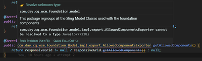

Some posts like this hinted at the possibility, but I have failed to get it working when I tried the suggested solution on my own. When I have tried implementing the delegation pattern for a custom ResponsiveGrid Sling model, I can't properly implement the interface ResponsiveGridExporter because the deprecated method getAllowedComponents doesn't have reference to the return type any longer. Code_t6bKHcemnB.png

That Level Up article using the Lombok delegation annotation looks really neat, unfortunately, even it throws the error about the return type not being found when it compiles it.
"Lombok annotation handler class lombok.javac.handlers.HandleDelegate failed on C:\...DtcComponent.java: com.sun.tools.javac.code.Symbol$CompletionFailure: class file for com.day.cq.wcm.foundation.model.impl.export.AllowedComponentsExporter not found."
But yea, simply overriding the getAllowedComponents and marking it as deprecated will simply make the compiler complain that the return type doesn't exist (package com.day.cq.wcm.foundation.model.impl.export does not exist), meaning your suggestions don't work.
