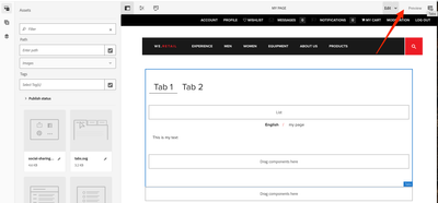

I want to create an AEM bundle that will extend the default editor.html UI and add a button near to the preview button.
Is it possible to do via a bundle?

I want to add the button programmatically using an AEM bundle that will do the job. I don't want to manually do anything or configure anything in AEM. I want to create a bundle that once installed, my users will have a new button in the editor UI.
