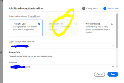

January 24, 2023
Thanks for responding @nitesh_kumar-1  ,  i tried its working fine
also one query - i already have a pipeline for
which is working fine
when i am trying add one more pipeline for  , Full stack Code is disabled . so can i have only one pipeline at a time ?
nitesh_kumar-1
January 24, 2023
Hi @sonuk85184451 ,
I'm glad that it's working.
Yes, At any time, there can only be one full-stack pipeline per environment.
For more details please refer to this documentation.
https://experienceleague.adobe.com/docs/experience-manager-cloud-service/content/implementing/using-cloud-manager/cicd-pipelines/introduction-ci-cd-pipelines.html?lang=en#full-stack-pipeline
