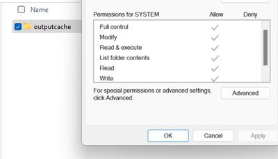

hi @BinaryAlchemy11
Its a permission issue on your local machine where you have aem instance running.
can you navigate to the location manually and try to see if you have perms to remove the folder , navigate to you c:path to bundles as given in the error screenshot and try to clear the content of the folder manually and see if that is working . Also check the properties of the folder under security tab and ensure you have full control eg:
if not try to add that and rerun that should help here
