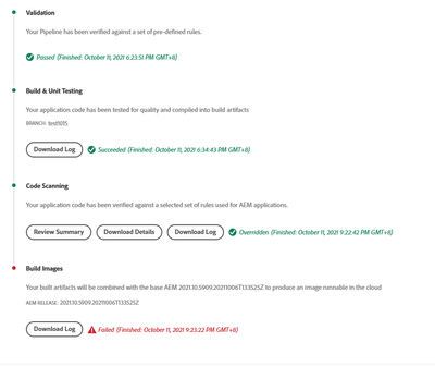

when I build deployment using pipeline in Cloud Manager,
dispatcher has error,But I do'not change any config.
the error message like this,

+ /usr/bin/dispatcher-configuration-validator full -d /tmp/dispatcher/configuration/publish /tmp/dispatcher/unzippedConfiguration
[0mCloud manager validator 2.0.34
2021/10/11 13:23:12 Deprecated configuration layout detected, enabling compatibility mode
2021/10/11 13:23:12 conf.d/available_vhosts/wey_publish.vhost:57: included file (conf.d/rewrites/wey_rewrite.rules) does not match any known file
The command '/bin/sh -c AZCOPY="/usr/bin/azcopy" VALIDATOR_BINARY="/usr/bin/dispatcher-configuration-validator" HTTPD_BINARY="/usr/sbin/httpd" DISPATCHER_CONFIGURATION_LOCATION=$dispatcherConfigurationLocation DISPATCHER_CONFIGURATION_DESTINATION=$dispatcherConfigurationDestination DISPATCHER_IMAGE=$dispatcherImage RUN_MODE=$runmode ./validateDispatcherConfiguration.sh' returned a non-zero code: 2
2021/10/11 13:23:12 Container failed during run: validate-dispatcher. No retries remaining.
failed to run step ID: validate-dispatcher: exit status 2
Run ID: caqg9w failed after 24s. Error: failed during run, err: exit status 1
how do I soved it ? Who can help me?
