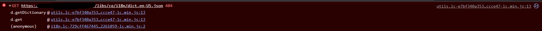

The console in browser is giving the below error -

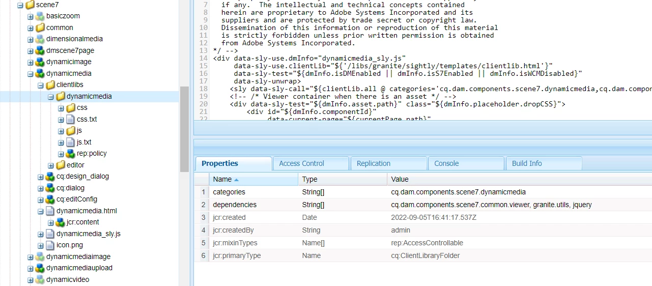

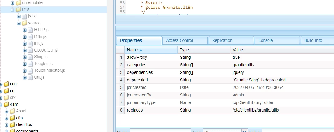

1. The clientlib category of dynamic media has category 'granite.utils' which calls i18n.js file.

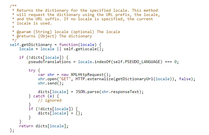

2. The granite.utils clientlib category at /libs/clientlibs/granite/utils has I18n.js with below code -
The code fails at the below lines -
xhr.open("GET", HTTP.externalize(getDictionaryUrl(locale)), false); //getDictionaryUrl(locale) returns "/libs/cq/i18n/dict.en.json"
xhr.send(); //Failed to load resource; server responded with status 404
