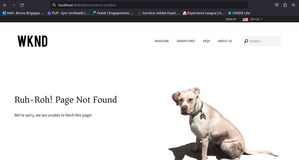

Well, I need to configure dispatcher so I can access a get servlet I've created. It works in author and publish instances. I've also already configured the dispatcher to run on port 8080 using docker and I'm able to access published content via port 8080. Nevertheless, when I try to access my servlet via this link: localhost:8080/bin/random-number it gives me this page with a 404 not found error when I check the browser console: image.png
The linux command I'm using to run dispatcher on my project directory through docker is
sudo ~/aem-sdk/dispatcher/dispatcher-sdk-2.0.174/bin/docker_run.sh /home/webjump/estágio/trilha-04/aem-wknd-3.2.0/dispatcher/src host.docker.internal:4503 8080

What am I missing? Are there any other files that I need to alter? How can I know where is the problem?
Update: this is what I'm getting with the debug mode

 Now I can see that the filter is rejecting the request, even though I've modified filters.any to allow it. Did I modify the wrong file? Is the syntax wrong? Is it missing something?

 I can see now that the filter is rejecting the requests, but why? I've altered the filters.any file in the dispatcher directory. Is it that I'm altering the wrong file? Or the syntax is wrong?
[Tue Nov 28 15:01:00.932313 2023] [dispatcher:debug] [pid 313:tid 139849276103480] [client localhost:33972] Filter rejects: GET /bin/random-number HTTP/1.1
Above log shows that one of filter is rejecting this path. I suspect your filters.any file is not loading in your dispatcher. Changes made on default_filter.any will never be picked up. How are you calling the filter.any file in your dispatcher setup?. Try setting up your custom farm for your site and then call your custom filters.any
I've found the problem. I've modified the filters.any file at the dispatcher installation folder, but not in the wknd project dispatcher directory. I'm sorry about that, I'm an intern and I'm not having as much help as I should (so I kind of need to figure things out on my own and adobe tutorials can be a little confusing or incomplete).
