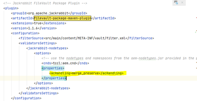

I was deploying the rep:policy in my AEM using archetype-28 and i faced the below error:
[ERROR] ValidationViolation: "jackrabbit-accesscontrol: Found an access control list, but it is never considered during installation as the property 'acHandling' is set to 'IGNORE'!", filePath=jcr_root\content\dam\project\numbers\_rep_policy.xml, nodePath=/content/dam/project/numbers/rep:policy, line=3, column=31
Solving the above error :
Go to your ui-apps pom file and add the property under the "filevault-package-maven-plugin" configuration.For your reference please see the snapshot below.
acHandling options: - ignore - overwrite - merge - merge_preserve - clear
or
You can also add this in main POM (but i did not try this to add here , I added in the ui-app/pom.xml).
For More details. Please follow the jackrabbit.apache.org/filevault-package-maven-plugin and Jackrabbit+FileVault+Validation
