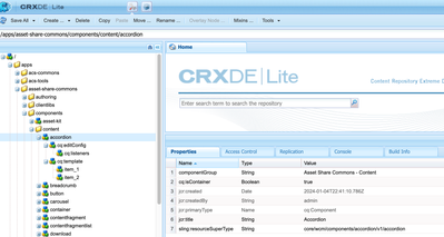

@shaheena_sheikh You can update the component group and update the type where it is used. So that next time when you deploy it will pick and install. If you want your asset to be in same group. Similar to below screenshot.
If not you can keep your custom component in your project and update the references where it is used. So that when you deploy the project your component and asset share commons both get installed.
