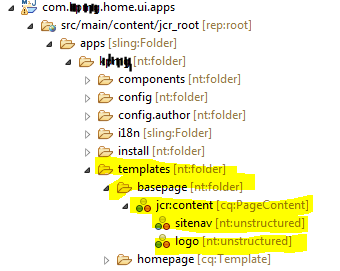

  •      I've added a node to my template which has a jcr:primaryType=nt:unstructured and sling:resourceType=/apps/myproject/components/structure/templates/sitenav (this is a navigation bar component).
  •      Also, the template has a sling:resourceType set to /apps/myproject/components/structure/templates/basepage.
apps/myproject/templates/page/base

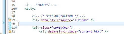

Further, the data-sly-resource="sitenav" is added in the /apps/components/structure/templates/basepage/basepage.html (basepage is the component that the template point to with sling:resourceType.
/apps/myproject/components/structure/templates/basepage/basepage.html
Now, on creating a webpage with the above mentioned template, I was expecting the Site-navigation to appear on the page, instead this is the result:
Webpage
It'll be great if someone can help me understand what I'm doing wrong here?
Also, when I add the entire path of the sitenav component...
path for resourceType...
it works....
Webpage works...with Site Navigation at the top...

okay , let me try to explain that to you.
    When you have <sly data-sly-resource="sitenav" /> that means , a resource by name "sitenav" under the current page node , (Not under the template) will be included and the "sling:resourceType" in the node will be executed.

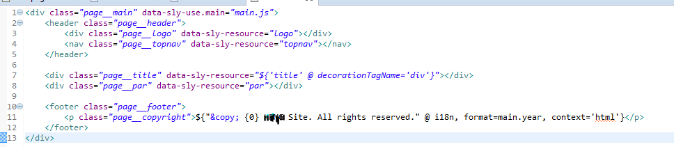

Yes, i think that is what I will do.  I saw the shorter version in the example Archetype11 app and though it is simpler to write, it can result in some additional manual effort to update each page-node if a new component is included.  Here's a screenshot of the Archetype11 app:
Archtype11  - /apps/<project>/components/structure/page/partials/main.html
cool. Yes I have seen that. But may be if Feike sees this question and can give bit more guidance that would be better i guess.

Hi Veena,
The data-sly-resource="<name>" would work anytime the node with that particular 'name' is available either under the template(/apps/<project>/templates/<templatename>/jcr:content) or under page(/content/<cq:Page>/jcr:content).  Screenshots are included for reference:
template.../apps/<project>/templates/<templatename>/jcr:content
page....(/content/<cq:Page>/jcr:content)
Saying this, I would now prefer to include the entire path of the component to reference it to avoid manual work of inserting the component on every page that is created.
