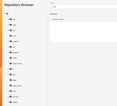

It is properly deployed in my local AEM SDK and I could see all my metadata schemas  but when I installed the same code in AEM cloud, I didn't see the metadata schema at all. I tried to see what is installed but I don't see any nodes inside /conf (even being administrator).

2 - Check if the custom metadata schema has been properly replicated to all AEM Cloud environments - How to check this as crxde is not enabled in stage and prod. I used to repository browser but /conf is not having any nodes.
