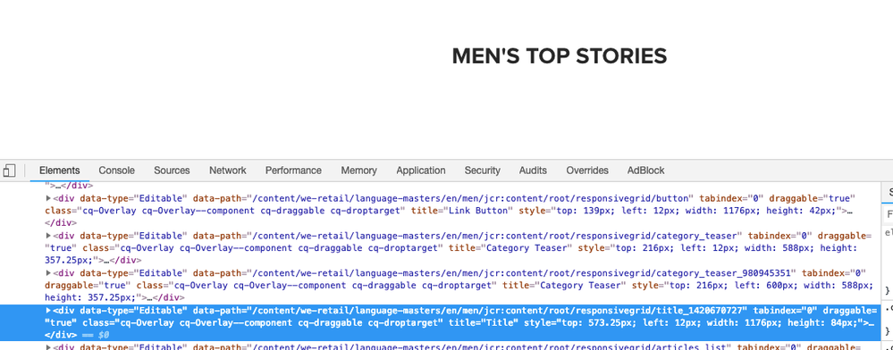

I think the problem is with the DOM here.
In edit mode your components actual DOM is loaded inside iframe and the component editable div loaded top of that, since this editable div and z-index higher so you can't interact with actual Dom in Edit mode.
E.g. Tab components, you must have to switch from edit to preview in order to edit another tab.
How to add parsys to Touch UI Tab Component
