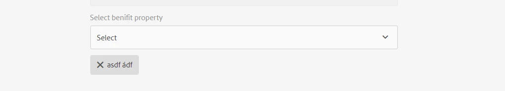

Hi Friends,
I am using selected multiple field. But it have problem, when I remove all values that I selected and save it. It can't save with none value selected.
Example: I selected one value and save ok.
after that I go to "Views properties" to edit that field and remove selected value.
When I save it comeback again.

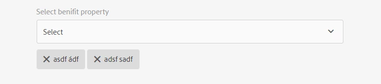

If I selected more than one options and save. After that I remove some option and keep one or more than one selected and save, it work fine. If I remove all options and save it, It come back the option before I remove.
Example: I select 2 options and save ok.
I remove one option and save it work fine.
If I select 2 options and remove all and save, it back to.

   resp.setContentType("application/json");
   resp.getWriter().write(gson.toJson(data.getContent().getBenefitDtos()));
Your issue is not reproducible. AEM does let you save with no values - see:
As we stated - replace your datasource with the article that Ratna pointed you too that uses WCMUsePojo!
When I click on anny position in the Coral UI form. It show an error
VM552:1 Uncaught SyntaxError: Unexpected token s in JSON at position 0
    at JSON.parse (<anonymous>)
    at receiveMessage (clientlibs.js:60)
When I click on clientlibs.js it goto the line code that happen the error as below.
     * Receive two-part messages from the TemplatePicker dialog.  The "data" part indicates the
     * template picker path should be updated; the "config" part indicates whether or not the
     * dialog should be closed.
    function receiveMessage(event) {
        if (event.origin !== location.origin) {
            return;
        var fromTemplateBrowser = JSON.parse(event.data);
        if (fromTemplateBrowser.sender !== "templatebrowser") {
            return;
        if (fromTemplateBrowser.data) {
            var $sink = $templatePicker.data("sink"),
                path = fromTemplateBrowser.data.path;
            $sink.val(path).change();
        if (fromTemplateBrowser.config) {
            var action = fromTemplateBrowser.config.action;
            if (action === 'close' || action === 'done') {
                $templatePicker.data("modal").hide();
Do you have anny idea for this. This bug have effect to remove all option in multiple select field?
Thank you so much,
BienHV
Have you tried using the logic in the article - Adobe Experience Manager Help | Using an WCMUsePojo class to populate an Experience Manager Touch UI...
As I showed in the 2nd video - this issue does not appear when using this Java logic.
YOu may have found a bug. IN your sample - you are using JSON and in mine - we are using a MAP and DataSource which is populating the Select field. As i showed in video - i am not experiencing your reported issue. I can save the dialog with no options.
I only used DataSource. But the bug still happen. If I remove many options and hole one option it work. If I remove all options it doesn't work. It back to the previous save.
I created a custom field for select and change the render.jsp file of the custom select field. So, I coded a JavaScript function to check the onchange of the select field. It work fine.
%><coral-select id = "abcProperty" <%= attrs.build() %>><%
    if (cfg.get("emptyOption", false)) {
        String value = "";
        AttrBuilder opAttrs = new AttrBuilder(null, xssAPI);
        opAttrs.add("value", value);
        opAttrs.addSelected(cmp.getValue().isSelected(value, false));
        out.println("<coral-select-item " + opAttrs.build() + "></coral-select-item>");
    for (Iterator<Resource> items = itemIterator; items.hasNext();) {
        printOption(out, items.next(), cmp);
%></coral-select><%!
<script>
abcProperty._onSelectionChange = function(){
        setTimeout(function(){
            var coralTaglist = $("#abcProperty> [name='./propertiesBenefits']")
            if(abcProperty._oldSelection.length == 0){
                coralTaglist.append("<input id = \"hiddenProperty\" handle=\"input\" type=\"hidden\" name=\"./propertiesBenefits\" value=\"\">");
coralTaglist[0].hidden = true;
            else{
coralTaglist[0].hidden = false;
        }, 100);
</script>
Hi bhoang! Thank you for your good problem description and the solution. It work for me.
Hi bhoang!
Thank you for your good problem description and the solution. It worked for me.
I just needed to change two coral-select properties:
onchange instead of _onSelectionChange
values instead of _oldSelection
I guess it is because of the differences between the Coral UI versions.
Your script with these changes stayed like this:
<script>
    benefitProperty.onchange = function(){
            var coralTaglist = $("#benefitProperty > [name='./propertiesBenefits']")
            if(benefitProperty.values.length == 0){
            else{
        }, 100);
</script>
Thank you again!
