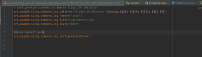

-------> Added configuration file path :
config -> org.apache.sling.commons.log.LogManger.xml
org.apache.sling.commons.log.configurationFile="/apps/test/config/logback.xml"

My understanding is that you can't override org.apache.sling.commons.log.configurationFile property for a custom factory, but I may be mistaken. At least it says so here. https://sling.apache.org/documentation/development/logging.html
I tried and the field wouldn't render in my system console... (http://localhost:4503/system/console/configMgr)
I think you can only set the logback.xml on the Apache Sling Logging Configuration
which points to the following directory to find your logback.xml: C:\Users\XXXXXX\aem\aem\publish\crx-quickstart (${sling.home})
... or wherever you have installed your aem instance for development purposes.

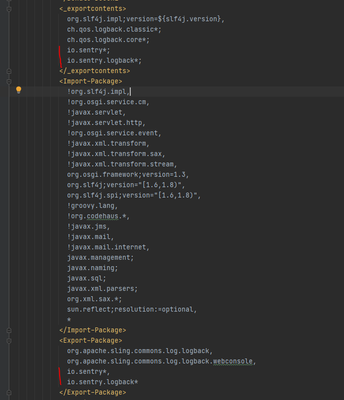

I managed to get logback.xml working with Sentry but it was an extremely customized solution. I had to download the org.apache.sling.commons.log
source code (https://github.com/apache/sling-org-apache-sling-commons-log). Add sentry packages to the code. Ensure those packages were exported. Compile the Apache library. Uninstall the old org.apache.sling.commons.log from AEM Bundles and install the newly compiled version. I also had to configure the binding within AEM on the Apache Sling Logging Configuration page, and it magically worked! I will post a youtube video at a later time on how I did this step by step. I am still experimenting myself and not sure if my company wants to implement this in production. (More detail in next reply)
The major caveat with using logback.xml is that you are now responsible for all logging handling within the file itself. It will override all org.apache.sling.commons.log.LogManager.factory.config in your aem project and any built-in handlers within aem. (Work around in further replies)
Perhaps I could have exported the sentry libraries from my own source code and that might also make them available without having to modify the sling commons source. Still learning with Maven... (Update: I tried, it doesn't work)

Caused by: java.lang.ClassNotFoundException: io.sentry.logback.SentryAppender not found by org.apache.sling.commons.log [15]
io.sentry.logback*  and io.sentry* must be locally exported libraries within the context of org.apache.sling.commons.log as I previously implemented.
version 5.5.1
version 5.1.10, this is the pom.xml
0. Be sure to check your version of apache.sling.commons.log in aem and download that version from Git Hub and build that. If you get an ant build javascript engine exception you need to install Java 8 a.k.a Java 1.8 SDK and build the source code. My instance of AEM 6.5 has 5.1.10 installed so I had to use Java 8 to compile the souce.
1. Make the changes as shown above.
2. Compile the source code
3. Uninstall the existing bundle for org.apache.sling.commons.log here... (http://localhost:4503/system/console/bundles)
4. Install the newly compiled bundle, set activate and set the bundle start order to 1 (logging should start first)
5. Update the Sling Logging Configuration to point to the new bundle under the binding section. This will now be an input stream since you installed it manually. Before it was probably sling as this was the install at the time of setting up AEM and was installed from the file system.
6. Configure logback.xml with sentry config appropriately to your threshold of logging
7. Reboot AEM and check logs for errors
The major caveat with using logback.xml is that you are now responsible for all logging handling within the file itself. It will override all org.apache.sling.commons.log.LogManager.factory.config files in your aem project and any built-in handlers within AEM. (Workaround in next reply)
Note that if you have multiple projects installed in AEM they will go to the same sentry DSN unless there is a way to filter based on logger configs. I haven't done this yet but in theory, you could configure multiple sentry appenders with various DSN endpoints. I have to test out still, but this is the idea...

If you update your logback.xml to include further files or any other changes in any child files you can reload them without turning off the aem server by clicking the update button on the org.apache.sling.commons.log bundle. This triggers a reset event and reloads the logback.xml at runtime via an event.
An OSGi event with the org/apache/sling/commons/log/RESET topic resets the Logback at runtime.
You can also accomplish the same through an aem service that loads a file or string and converts it to an input stream. You would have to test, but I believe the reset event may retrigger this source too, not sure. A deployment of your source doesn't retrigger this service but rather when AEM boots up.

I will try tomorrow with a log Manager.xml config. I think it will just create another root global sling logging configuration or update the existing. So everything I stated already may still very well apply. Just a different approach potentially. Not sure what kind of binding control it offers. Looks the same according to documentation potentially.
I have no idea how to create another global sling config or set the above properties in it directly via a config file unless I modify the org.sling.apache.commons.log source code directly. I believe this is only a config that can manually be set through the user interface. I think you can only override the following as stated in the documentation.
If someone knows how to set those properties via some sort of global config file or bundle config please share. I don't believe the previous comments to be true but I may be incorrect.
@cakayastha Did you find the suggestions helpful? Please let us know if more information is required. Otherwise, please mark the answer as correct for posterity. If you have found out solution yourself, please share it with the community.
@kautuk_sahni  Noop, not yet,. Did try both suggested ways but neither one working.
