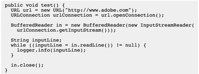

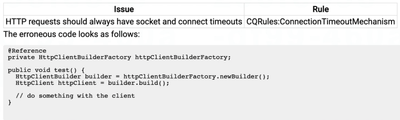

The code quality step for the Non-production pipeline threw the following error.
what is the correct code snippet to replace the above code.

Thanks in advance!

Option B
public void test() {
    HttpClientBuilder builder = httpClientBuilderFactory.newBuilder();
    RequestConfig requestConfig = RequestConfig.custom()
        .setConnectTimeout(5000)
        .setSocketTimeout(5000)
        .build();
    builder.setDefaultRequestConfig(requestConfig);
    HttpClient httpClient = builder.build();
    // do something with the client

정확한 답변 작성자:
Option B
        .build();

Thanks a lot.. This explains well
