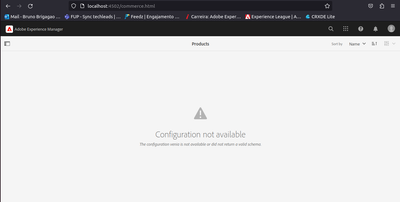

I'm an intern and my current task is to setup the CIF addon and the Venia project. While I was able to install both the project and core components, when I try to access Venia store through Commerce icon in AEM I get the following response:
I've double checked the installation files regarding author and publish instances, the bundles for the venia project and cif core components are installed and active. I've asked my superior if I needed to have Commerce installed and he gave me no as an answer. He said that I could use/set venia.magento.com as an environment variable and it should work fine. It didn't. I've also tried to follow the steps of this link:
https://www.tothenew.com/blog/install-and-configure-the-cif-add-on-in-aem-to-connect-venia-store/
But was unable to set it up. Do I need to install Adobe Commerce or is it really not necessary? How can I set up my commerce endpoint and environment variable so I'm able to access commerce through AEM? Any hints on where is the problem or how can I look for logs to find the problem?
@RafaelSp we need commerce to be hosted somewhere and provide commerce endpoint details in osgi
What do you mean by host commerce? I think what he meant was to use venia.magento.com as a host for commerce, so I've set it up as the commerce endpoint. Did I misunderstood? In order to host it, do I need to install and configure adobe commerce or the CIF add-on is enough?
These are my Commerce endpoint details in osgi:
Is it wrong? I'm kind of lost in this task and not receiving the help I should from my work colleagues.
