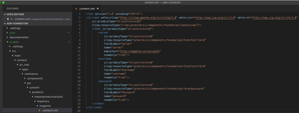

Code snapshot:
I changed  sling:resourceType="/libs/granite/ui/components/foundation/layouts/well"  from sling:resourceType="/granite/ui/components/foundation/well"

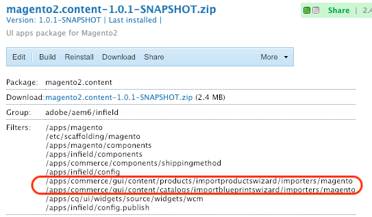

The package has contents as below:

I was able to fix this. So the updated was to change jcr:primaryType="sling:Orderedfolder" instead of jcr:primaryType="nt:unstructured".
Fixes:
1. Replace jcr:primaryType="nt:unstructured" with jcr:primaryType="sling:Orderedfolder" for jcr:root (line 3) for both the below files:
  • .content.xml file under /magento2-aem-connector-master 2/aem-connector/ui.apps/src/main/content/jcr_root/apps/commerce/gui/content/catalogs/importblueprintswizard/importers/magento/
  • .content.xml file under /magento2-aem-connector-master 2/aem-connector/ui.apps/src/main/content/jcr_root/apps/commerce/gui/content/products/importproductswizard/importers/magento/
2. Rebuild and install the package 'mvn clean install -PautoInstallPackage'

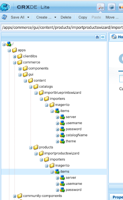

Check the repository.. nodes should have installed correctly:

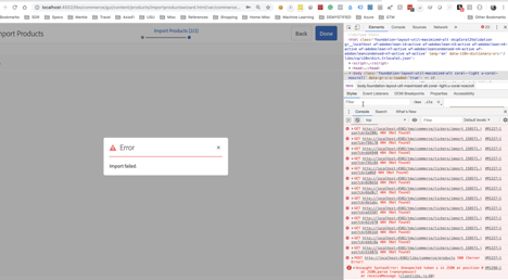

I'm facing a problem to import product list from Magento to AEM. The error that I get during the import process is captured in the first screenshot. As you can see console log errors in the screenshot I do get the same errors when I import catalogs from Magento to AEM 6.4, however, the catalogs got imported, see the second screenshot
First screenshot:
Second screenshot:
Can somebody help how to resolve this issue.
