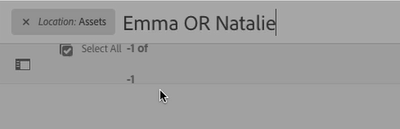

I need to search for assets that meet various criteria, such as having either of two tags, using Boolean search options. I follow the below steps and get a -1 error message.
1. In Adobe Experience Manager Assets, click the search icon
2. Enter a search string using Boolean operators (Eg; Ocean OR Mountain)
3. Upon submitting, AEM will return of “-1 of -1” result
Has anyone experienced this error? Please suggest possible solutions. Thanks!

Hi @NikhilaB
I'm not able to reproduce this error. Can you provide the exact string you are trying? For me it is showing different results with "or" and "OR" with and without quotes for the individual terms etc.
My guess would it should be how the search query is formatted while trying to search for it.
You can take a look at this recording for troubleshooting search issues - https://experienceleague.adobe.com/en/docs/experience-manager-learn/foundation/troubleshooting/how-t...
This is what I get. I ensured that I have assets with these names in the DAM before I performed the search. For Boolean search, you have to give "AND"/"OR" in all caps for it to work.
Thank you for sharing the recording. I will take a look.
I tried multiple variations but unable to reproduce this issue on my end.  All I see is the no results found message
"Sorry, we couldn't find any results for Emma OR Natalie
Make sure all the words are spelled correctly, try to refine your keywords or clear the enabled filter"

Thank you for the detailed response. I was able to find through the elimination method that giving access to the path var/dam/content resolved the issue. I don't know what this path is intended for or what additional features it would permit. But I am hoping it will not break any existing capabilities or accesses. Do you have any insight on what this path is intended for?
