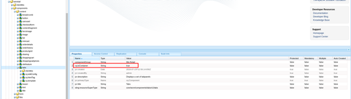

Have you added cq:iscontainer value as true? If not please add and give a try.
Hello @malay_dube ,
Thank you very much for the quick response.
cq:iscontainer value as true - it is already set in the Tabs component's property (In Core Component)

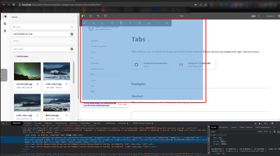

I also faced the same issue. In my case, it was not fixed by page refreshing. And it's not related to the we-retail and my local project. I found this in the core-components-library demo section also.
My Steps:
1. Add Tab/Carousel component
2. Add Image component in every container. Probably after adding image in 2nd container the issue will be generated.
Steps recording: https://www.loom.com/share/807092951323465ea48b6bd5e89d4c28
There is an overlay of the 2nd container image. In that particular area, I was unable to edit any other component. I added a screenshot below.
