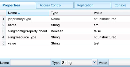

my Ca-config is stored as follows:

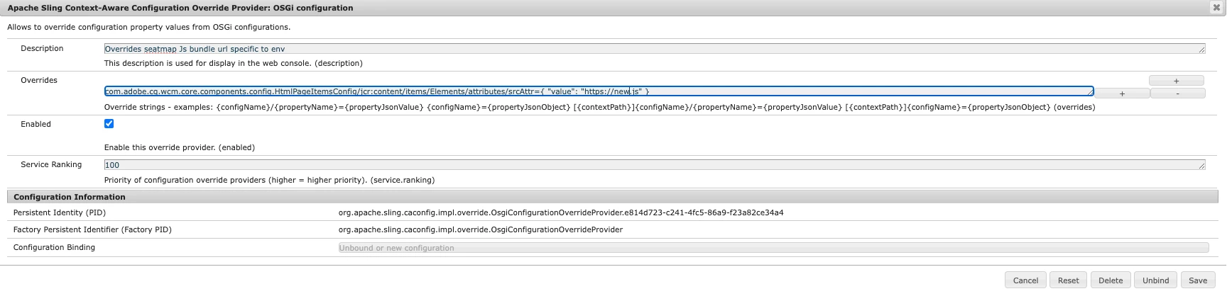

 I want override the "value" property of srcAttr and my Override provider config is as follows: 
but I am unable to achieve it,

I have tried the way you have mentioned, syntax issue is solved but I am unable to override the property.
In general if you look at any ca-config, the properties are stored under jcr:content node, but for this config it is stored in the child resources present under jcr:node, this is causing some issue in identifying the property. is there a way to point the property for such configurations?
