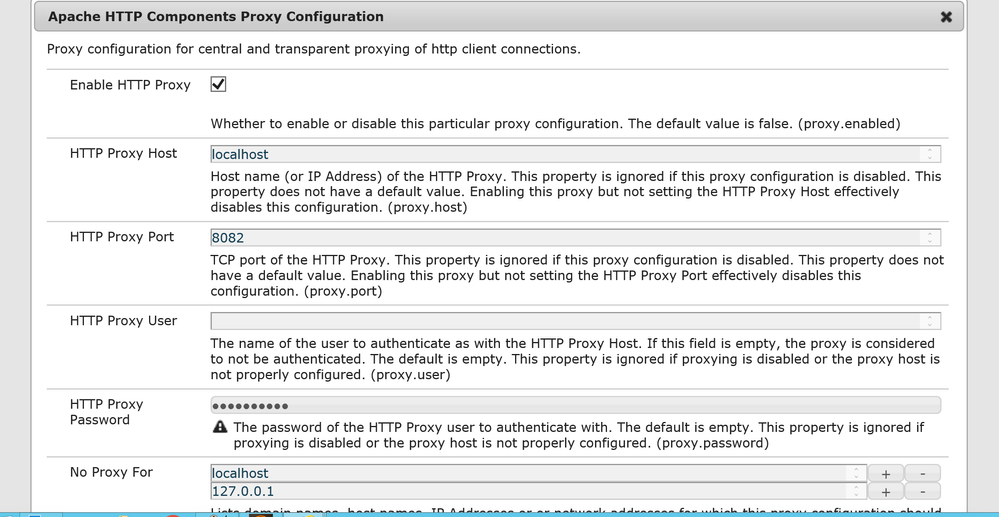

Can you share a screenshot of your configuration (scrub the sensitive details) and a code snippet?
Sure just running a simple HTTP GET to google:  AEM log shows the GET itself is successful.  I have a apache proxy running on localhost (screenshot attached). Viewing the apache access log I can see there is no connection through the proxy.

Hi Joseph,
Actually you're configuration settings did work! For some reason the apache logs with this configuration showed a 5 min delay. Thanks again for your help!
