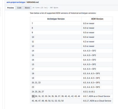

AMS code repo is on Maven archetype version 17 or 19 and AEMaaCS on recent version.

Hi @SrikanthPo3 ,
You may use repository modernizer tool, as discussed in reference link for archetype 24.
Reference https://experienceleague.adobe.com/en/docs/experience-manager-cloud-service/content/migration-journe...
https://ms-29.com/aem/cloud/repository-modernizer-update-archetype
As for as null pointer you may try @ScriptVariable and better to have injection Optional if possible. However it all depends on requirement

You may cross check HeaderNavigation in your  project
Also there is double dot, ensure it is included correctly
com.core.aem..components.model.HeaderNavigation cannot be correctly instantiated by the Use API
Apart from that project should be minimum archetype version of 28 for aem cloud as per https://github.com/adobe/aem-project-archetype/blob/develop/VERSIONS.md which seems the major cause of error
Have a look https://experienceleague.adobe.com/en/docs/experience-manager-core-components/using/versions for core component  compatibility
Thanks @MukeshYadav_
