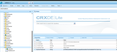

@SaitoYoshio  The log says keystore password not present at /etc/truststore path.
  1. Have you validated the crypto encoded value in the property keystorePassword in below path: Uppari_Ramesh_0-1752856540579.png
  2. The property keystorePassword contains crypto encoded trustore password. Check if this property is available.
  3. If not available you need to delete existing trustore and then you need to create new one. Beware that deleting trustore will get more problem if you had any other certs in it before.
