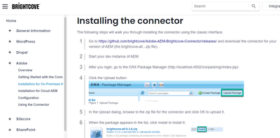

  1. Installation guide for On-Premises mentions to install the brightcove-all...zip file from the https://github.com/brightcove/Adobe-AEM-Brightcove-Connector/releases/ (refer below image for reference). But on the release page there is no 'brightcove.all-<version>.zip' for On-Premise, instead it contains 'brightcove_connector.ui.apps-<version>.zip' .
  2. After installation of 'brightcove.all-<version>.zip', the 'Brightcove Service' configuration is missing from the AEM Web Console configuration manager (which is mentioned on the installation guide 'Configuration' page. Refer below screenshot for reference).

@vikram03 I am able to see, can you please cross check if you are by mistake installed cloud brightcove zip in place of op premise
https://github.com/brightcove/Adobe-AEM-Brightcove-Connector/releases/tag/6.0.5
