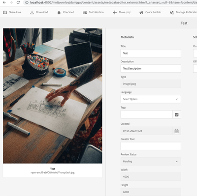

We are planning to consume AEM DAM assets (mainly documents/images) in a 3rd Party system by leveraging the out of the box HTTP assets API.
However, the existing API does not expose all fields from metadata. For example: My image has title and description set in metadata.
API response: http://jsonblob.com/993978613842067456
API response does not contain title/description in metadata. Is there a way we can modify the OOTB HTTP api and extend it to have additional fields in response?

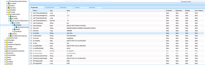

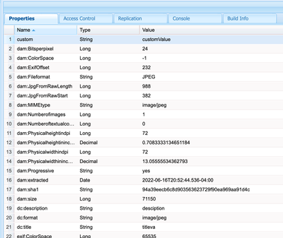

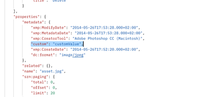

Custom properties added to the assets will be fetched by assets API. Such as if you have an additional field as "custom" which is having a value of "customValue" in the metadata node of the asset, when you try to fetch the metadata for the particular asset, it will fetch the additional metadata and will show in the JSON response.
Screen Shot 2022-07-05 at 5.30.31 PM.pngScreen Shot 2022-07-05 at 5.30.57 PM.png
you can see any property starting with dam:*, dc:* are not getting pulled into the JSON response whereas any custom property will be pulled into the response.
Unfortunately Asset HTTP API doesn't have any configurations to allow them.
