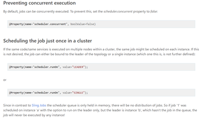

Please find the screenshot for concurrent and cluster job configurations
Reference URL : https://sling.apache.org/documentation/bundles/scheduler-service-commons-scheduler.html#preventing-c...
