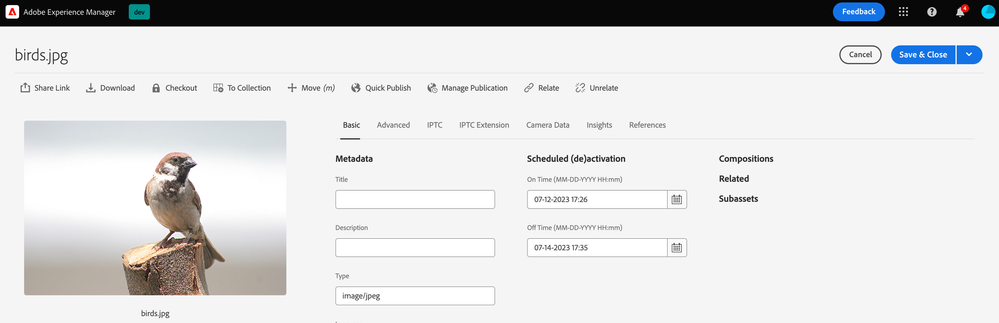

I have uploaded 3 images in this folder. Then, i have selected each images one by one and get into the "properties" of each images.
In the "Basic" tab of "Properties" i have set the "Scheduled (de)activation" like this:
On Time (MM-DD-YYYY HH:mm): 07-12-2023 17:26
Off Time (MM-DD-YYYY HH:mm): 07-14-2023 17:35

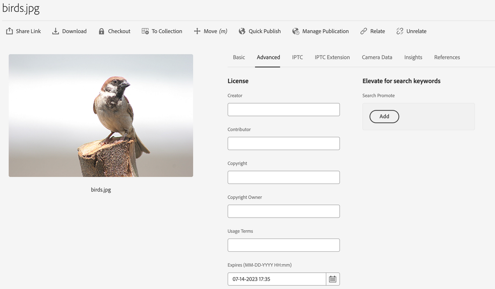

In the "Advanced" tab of "Properties" i have set the "Expires (MM-DD-YYYY HH:mm)" like this:
07-14-2023 17:35

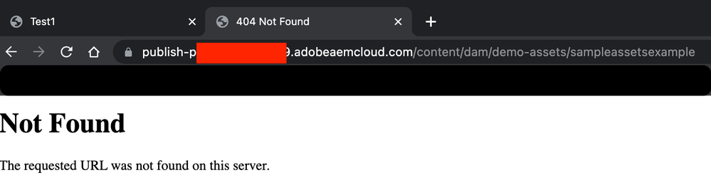

Can you tell me how to check this in the publish instance of aem as sandbox? i mean how to log into the publish instnce's crxde.
You can try accessing the asset file directly on publish url
Using the sandbox i have tried accessing the asset file directly using the publish url. The url was like this: "https://publish-pXXXX-eXXXX.adobeaemcloud.com/content/dam/demo-assets/sampleassetsexample"
But unfortunately i got the "Not found message"
I have also tried it in local environment. The images are still there. Any opinion on that.
On your example file extension is missing from the url and if you think that url is correct then above response shows that the asset is no longer available on publisher
