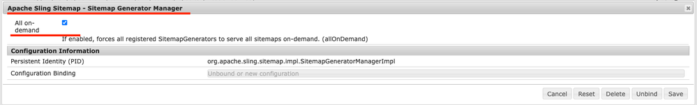

I have following configuration in config.author.local
However, sitemap-index is not getting generated.

So there needs to be a sitemap-index at location1, location2 and domain. From what you mentioned, I simply need to request for top level with sitemap-index.xml without any additional configuration, right? I did that but it did not work
The thing is, I am generating sitemap in author. Can I visualize sitemap-index in crxde? I can see sitemap.xml in my crxde but not sitemap-index
