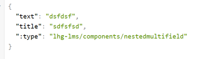

I am using nested multifield in AEM6.5 SPA with react. It is not rendering in model json.

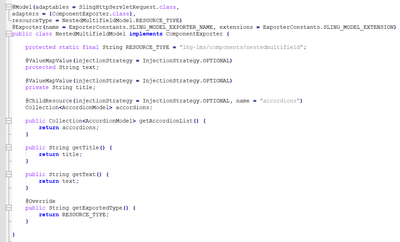

Did you create a separate sling model to read the values of nested multifield from JCR? If yes, I would check whether the sling model has the ComponentExporter adapter and Exporter annotation for exporting the values via the model.json framework.

How are the values persisting for nested multifield in JCR? If you're persisting the property values in node hierarchy (child nodes for nested multifield values), then you've to read them in the Component Sling Model using the Child Resource From Request Injector.

Yes values are persisting in jcr also loading in cq dialog. I am using childresource annotation for the element in sling model.
Still it is not rendering in model json.

Other fields are appearing in model json.

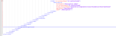

Hi Kiran,
I am sharing below for reference.

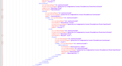

JCR structure

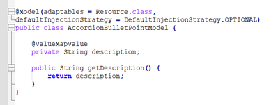

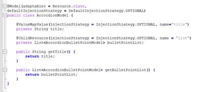

Sling models
Model json

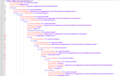

CQ dialog
Hi @pradeepdubey82 ,
Try to inject like this
	@Inject
	@Via("resource")
	@Named("accordians")
	private List<Resource> accordians;
Try to adapt each resource to AccordionModal
	public List<AccordionModal> getAccordionModalList() {
		List<AccordionModal> AccordionModalList = new ArrayList<>();
		if (null != accordions) {
			accordions.forEach(i -> AccordionModalList.add(i.adaptTo(AccordionModal.class)));
		return AccordionModalList;
Do the same thing for AccordionBulletPointModal.

Hi @pradeepdubey82
AccordionModel & AccordionBulletPointModel are missing the Exporter annotation to export the values via Sling Model Exporter framework.
Add the following annotation to both the sling models
@Exporter(name = ExporterConstants.SLING_MODEL_EXPORTER_NAME, extensions = ExporterConstants.SLING_MODEL_EXTENSION)
