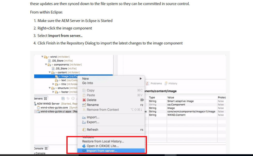

See the WKND tutorial which I have pointed out. You can do very easily using Eclipse AEM plugin by "Import from Server". See the below screenshot.
Hope this helps!!
~Ratna.
