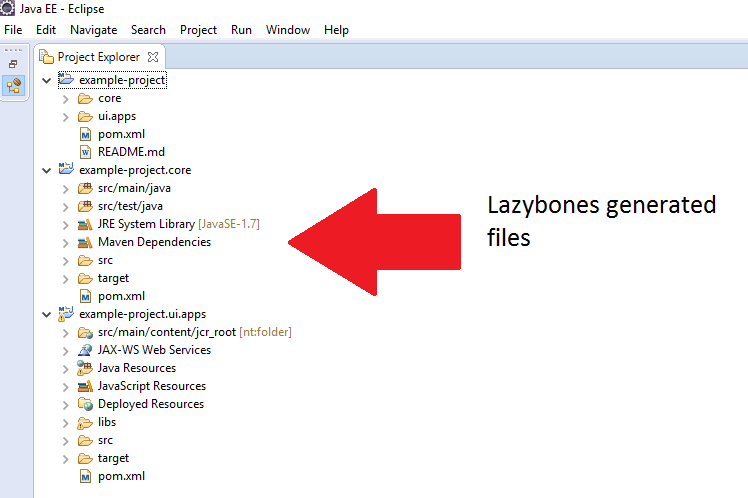

-- Created a new project using lazybones
-- No changes to pom.xml made yet
-- Maven verison 3.5.0 and AEM 6.3 is being used.

Thank you for the response. I have created the project using the same steps. Although, I would expect the build process to install all the content in CRXde. Currently, only the project folder structure is being deployed to the CRXde, all the components, clientlibs, editable templates etc, none of them gets installed to CRXde. This is the issue I am facing. When I do the Maven build through eclipse/cmd prompt, all it does is it install the project structure with folders minus any components, templates, clientlibs etc.
When you import from Eclipse into AEM JCR - you should be seeing:
I have completed the article successfully and used lazybones to create the project. Normally, I create the components, clientlibs etc in CRXde and then export them to local filesystem/eclipse and commit it to GIt. I checked out the project from Git on a different machine, did a maven build in the hopes of seeing all my components/templates etc in CRXd which didn't happen. Only the project structure with empty folders got deployed to CRXde.
To look further into the issue, I created a test component in CRXde, exported it into eclipse using vlt up and then ran a build again only to find out that the test component wasn't deployed to CRXde. Although, I could see that test component in the zip created by the maven build.
