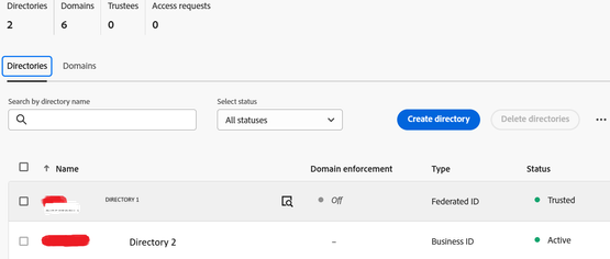

I am trying to use Adobe IMS for SSO for our author instance and Admin console ,as we are migrating we already have Directory and domains in AMS , as per adobe we raised the request for domains and got it approved .
In Admin console I can see directories
I need the SSO to be applied for the domains under directory
I have gone through the adobe docs and i have arrived till this step , please suggest me the next steps to be followed so i can successfully integrate  SSO for Author and Admin console , and how to validate them

Hi Everyone the login using custom SAML provider is working, the issue is all users in our directory was created using Adobe IDs for which federated login will not work, so i created a user with federated ID and tried logging in SAML started working , I was able to login as well as i was able to control the permissions using user groups .
Thanks ALL ,
