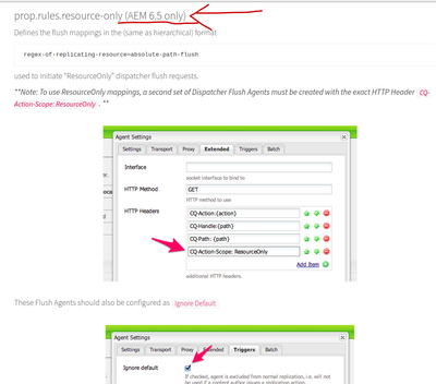

prop.rules.resource-only is only applicable for AEM6.5
For AEMaaCS you probably will have to change the rules and try using
prop.rules.hierarchical
https://adobe-consulting-services.github.io/acs-aem-commons/features/dispatcher-flush-rules/index.ht...
