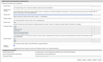

Cors is not working.  We added a "*" based entry in the configmnager, but this does not help either.
Using postman, we see the header Access-Control-Allow-Origin  is not being set in the response from AEM. Is this normal?

At a first glance, your OSGI configuration looks ok and things should work as expected.
For further debugging I would refer your to the Troubleshooting section of the "Understanding CORS" documentation page. Please create a logger for the com.adobe.granite.cors package on DEBUG (or even TRACE) level and see if you can find additional insights on the matter.

could it be something with "supported headers"? I cant find any info on what these are for, and, explicitly, what happens if the client supplies headers which are not in this list.
You can double check on the "supported headers" if you replace them with a wildcard (*) to allow any. In addition to that you may want to deactivate result caching for debugging purposes by setting the max age property to "-1". Have you already activated debug logging and checked the log files as suggested in my initial response?
Level 9
supported headers was the issue, thanks. * fixed it. Its only for author.dev, not prod.
