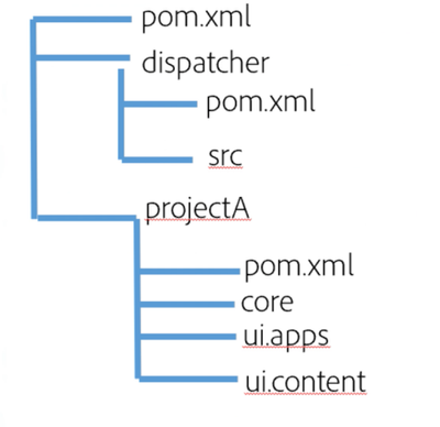

A developer wants to migrate the following project structure to AEM as a Cloud Service.
Level 7
what should developer do ?
a.
b.
c.
d.
Hi @JakeCham,
Answer C is correct, as it represents basic structure that you will get generating project using Adobe AEM Project Archetype.
See below links to get more information about AEM Project structure, and each module:
Hi @JakeCham,
Option C adheres to the latest archetype.
