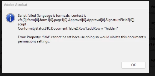

I was wondering if there is a way to make the buttons disappear once the form is signed? Everyone has to use electronic signatures to sign. I used the "postSign" function, but when I test it I get the following error:
Alternatively, if I use the "preSign" option, the buttons don't go away. 😞

@mav_s The XFA spec suggests:
The preSign event fires when a signature is about to be applied. A script triggered by this event
has the chance to make fields read-only or (in an interactive context) issue a custom dialog. If the
script is marked to be run only at the server, the data is sent to the server with an indication that it
should run the associated script before performing the rest of te processing.
After successfully applying a signature the postSign event fires. A script triggered by this event
has the chance to make fields read-only, issue a custom dialog, or submit the signed data to a
host. After a failed or cancelled attempt to apply a signature a postSign event also fires to allow
clean-up code to run.
So, you cannot show/hide fields on pre/post Sign events. For more details:
[1] XFA Spec:  https://www.pdfa.org/norm-refs/XFA-3_3.pdf (Page : 394)
[2] PreSign event:  https://help.adobe.com/en_US/AEMForms/6.1/DesignerScriptingBasics/WS92d06802c76abadb39b5236b129f6917ab6-7f72.2.html
[3] PostSign event: https://help.adobe.com/en_US/AEMForms/6.1/DesignerScriptingBasics/WS92d06802c76abadb39b5236b129f6917ab6-7f74.2.html
