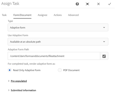

As I stated earlier, you need to configure the same as below:
Level 7
Level 7
@Mayank_Tiwari Yes, I did that - not working.  Can you review my workflow, form and startpoint?
Why are you using "submitted to workflow" for AF, when you are not invoking the workflow on AF submission? You are invoking the WF through code, right? You should use, "Absolute path of AF instead". I tried the same, and it is working fine for me, and I am able to attach the files, as per the advanced tab settings. Also, which version of AEM you ar trying this on?

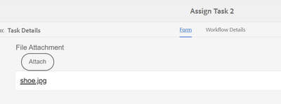

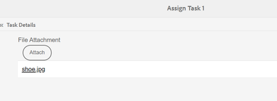

I installed your workflow package in 6.5.10, and modified it as below. Prepopulated and submitted info are blank in both the Assign tasks as yours.
Assign task 1 props:
Assign task2 props:

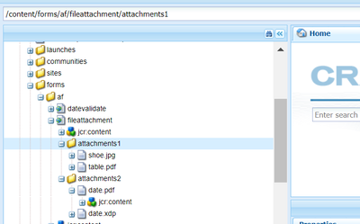

I invoked the workflow manually, and these are the attachments I have attached while submitting the tasks, and they are stored at the respective paths, as shown below:
Level 7
Ok, yes, in the CRX, that is also working for me.  Great - we're making progress but, this is not what I am asking.  The users need to see the attachments from task #1 to task #2 to task #3, etc from the inbox - the CRX is not accessible by a normal user

I checked with Adobe Engineering and I found that prefilling of Task attachments is not supported yet. That's why it is not working for task attachment. Engineering has confirmed this should be logged as an Enhancement. As of now, we can only prefill the AF attachment component, with the attachments submitted in the AF in the previous Assign task.
For this, you don't need to invoke the workflow on AF submission. It can be invoked manually too. You just need to have the file attachment component in the form you would render in the Assign task.
I have not configured anything in the Advanced tab of both the Assign tasks.
AssignTask1 props: only Submitted info is configured.
AssignTask 2 props. Only prepopulated is configured.

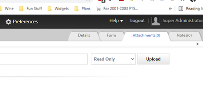

Maybe I'm expecting it to behave differently than it's designed.  I am expecting Attachments to show up here on subsequent tasks.  If I click on Workflow details, I can navigate to the previous task assign and see the attachments.  In our use-case, there could be 20 task assignments in 1 process instance - how would anybody know which one to find attachments?
In LiveCycle (screenshot below), the attachments could flow from one assignment to the next assignment in the attachment tab.
