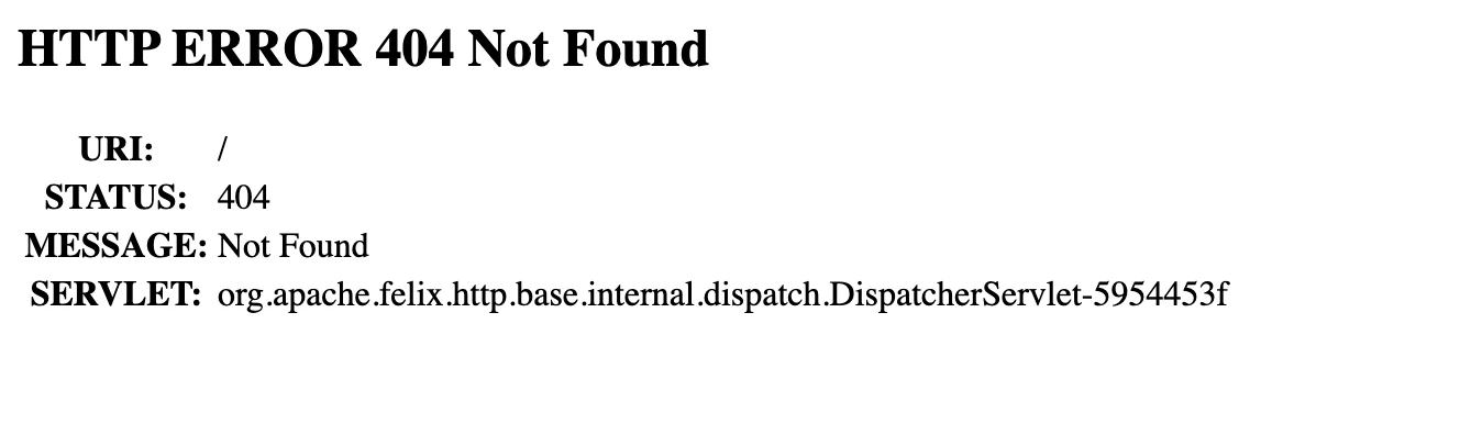

MohanJo1Author
January 30, 2024
Hi @b_sravan - I'm still seeing error shown in below screenshot after doing same steps.
Here are my versions-
aem-sdk-2023.12.14538.20231205T165334Z-231200
aem-forms-addon-2023.10.25.00-231100.far
java --version
openjdk 11.0.13 2021-10-19 LTS
OpenJDK Runtime Environment Zulu11.52+13-CA (build 11.0.13+8-LTS)
OpenJDK 64-Bit Server VM Zulu11.52+13-CA (build 11.0.13+8-LTS, mixed mode)
below error while accessing localhost:4502 in browser
