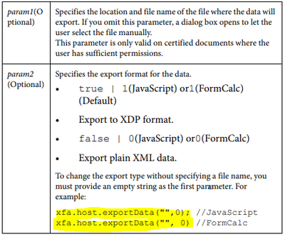

See Designer Scripting Reference (adobe.com) and look for exportData
There it says
For security reasons, if you provide the first parameter, the exportData method executes only
when performed on certified documents. If you do not provide the first parameter, the document
does not need to be certified and the user is prompted to provide a location and filename.
Only the user is prompted option will work OOTB. Certification can only be applied on the rendered PDF and you must have a valid certficate to certify. You can certify with Acrobat Pro (or AEM Forms server).
There it says

I dont have the valid certificate so I am trying with second approach.
form1.#subform[0].saveas::click - (FormCalc, client)
xfa.host.exportData("", 0) //FormCalc
form1.#subform[0].saveas::click - (JavaScript, client)
xfa.host.exportData("",0)//javascriptript
Both of the above approaches are not working.

@shyamasundar-ks , I did test this in Acrobat Pro and had no problem, with an empty path/filename the dialog opens.
Then I went to a different system where I have Adobe Reader installed. I tried the same thing and it did not work.
I applied Reader Extensions with Acrobat Pro on the PDF to allow saving data. But Reader still rejects it with the same message I see on your debugger.
I did some research and it seems that the exportData method is not working in Adobe Reader even with Reader Extensions applied.
I then certified that PDF and applied ReaderExtensions but it still did not work in Adobe Reader. Unfortunately this seems to be the situation also for other people out there.
